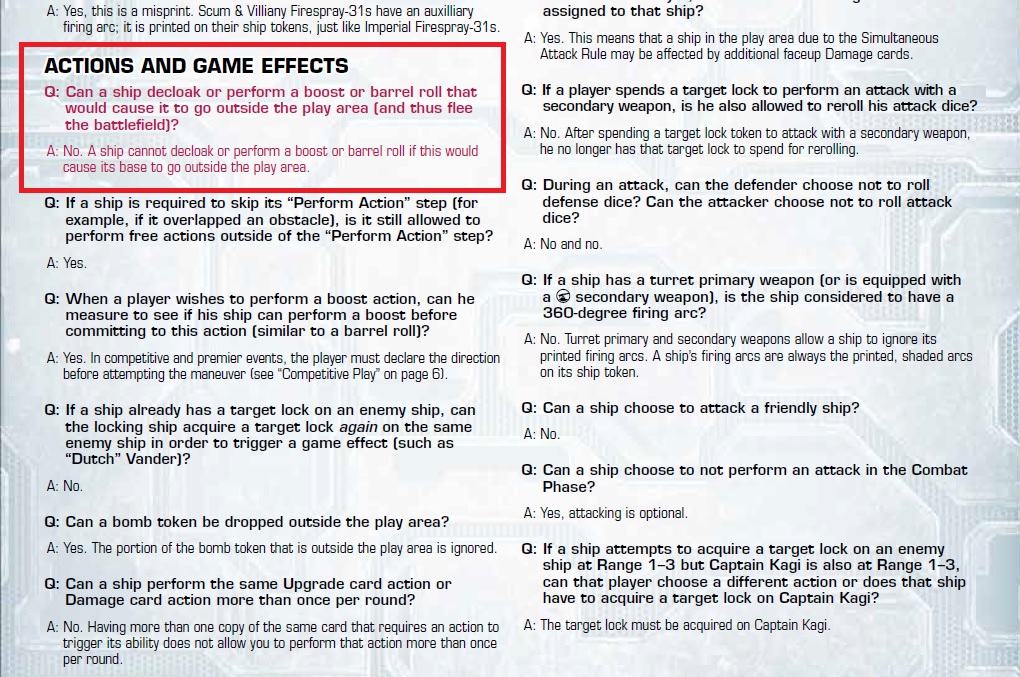

Du hast ein altes faq, im aktuellen kann man weder runter Rollen noch cloaken noch boosten.
Q: Can a ship decloak or perform a boost or barrel roll that
would cause it to go outside the play area (and thus flee
the battlefield)?
A: No. A ship cannot decloak or perform a boost or barrel roll if this would
cause its base to go outside the play area.
